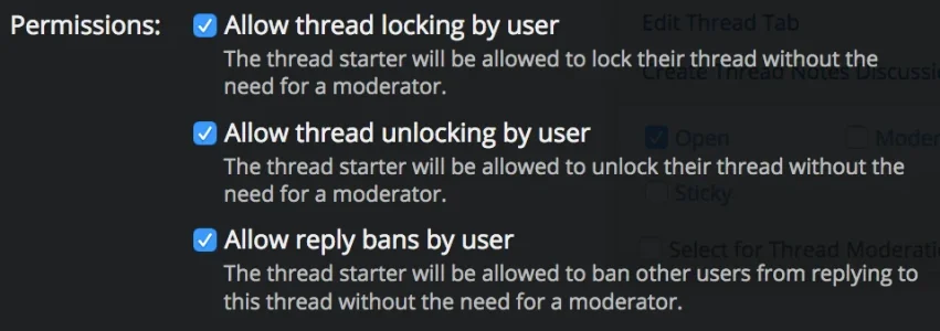

Big problem with the reply ban access to own thread, your permission gives them access to every thread, regardless who created it.
Suggestion: this needs an ACP log for admins to monitor who is being reply banned by members with such permission, to ensure it isn't abused, considering its a mod feature otherwise.
