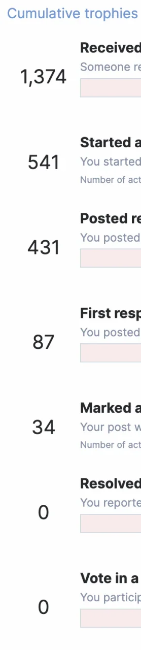

The next time someone reports it, could you please try to identify first whether it's a milestone or cumulative trophy which isn't being counted.It's hard to replicate.
I just notice it when some user reports their total is off.

Hi,The next time someone reports it, could you please try to identify first whether it's a milestone or cumulative trophy which isn't being counted.
And then which trophy. The difference between what it is and what it should be might indicate which trophy it is.

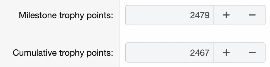

To help diagnose, if you rebuild trophy points, does that fix it?Hi,
It happens again now.
From the admin page, edit user page, the cumulative trophy point total is correct (2,467).
But the milestone trophy point is wrong, like for this one user it should be only 17, but it counts 2479, which is too high and wrong.
Member profile public page stats:
Admin, Edit user page:
That is a very long process to run.To help diagnose, if you rebuild trophy points, does that fix it?
/admin.php?tools/rebuild
Going to DM.That is a very long process to run.
It's quicker to just run "Rebuild user caches", and it fixes it
