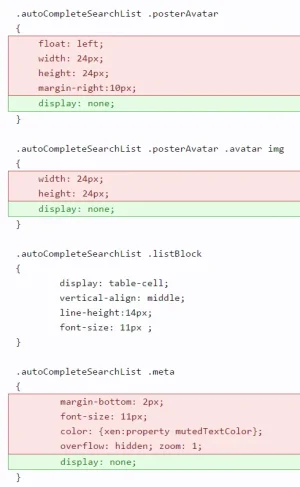

Any other way of removing the unnecessary element?
Except doing it via CSS, like removing the template code itself.
For now I did it this way:
What do you mean "the unnecessary element" ?
I assume you want to strip information out of the auto-complete results? Using css would be the quickest way like you have done.

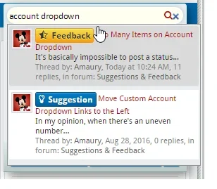

on TAZ, I found the addon interfered with my ability to use the search dropdown.
As you can see from the image above ... It almost entirely covers the search dialog.
I made a few mockups where the results are either embedded at the top or bottom of the search dialog.

A significant problem with this addons autocomplete is that it makes it seem like the autocomplete results equals ALL search results. As if there is nothing more to find. The user uses the autocomplete, sees no relevant result and then concludes that the search engine doesn't work or there is no content.
If there are no autocomplete results the member even gets the message 'No Matches' implying that there are no search results to be found in the search engine.
For some reason the autocomplete does not display the same results as a full search.
I get a lot of complaints about search due to the above issue.
I suggest to resolve this problem by adding a 'More results...' link under the autocomplete results and never display 'No matches' because its deceptive.
