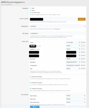

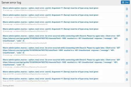

  • As mentioned above, it can connect to the Discord server but it goes offline all the time. It doesn't STAY connected unless I click TEST CONNECTION (or HEARTBEAT) from the XF Admin panel. As soon as I close that browser window it goes offline again.

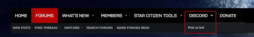

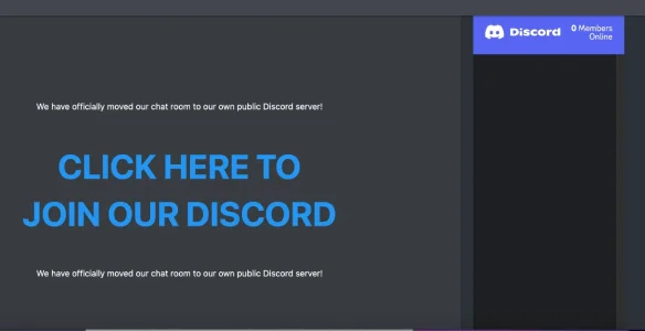

  • It doesn't show the user count in the NAV menu despite it being selected (see IMAGE #1 below)

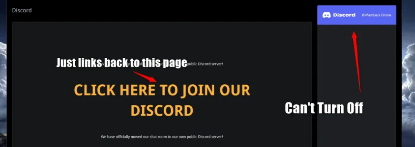

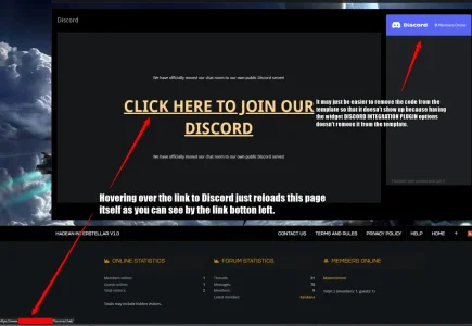

  • When clicking DISCORD the actual link to the DISCORD SERVER just has my own forums/chat URL (see IMAGE #2 below)
  • Can't disable what I am assuming is the WidgetBot.io on the right side of the page despite it being DISABLED In settings (see IMAGE #2 right side)

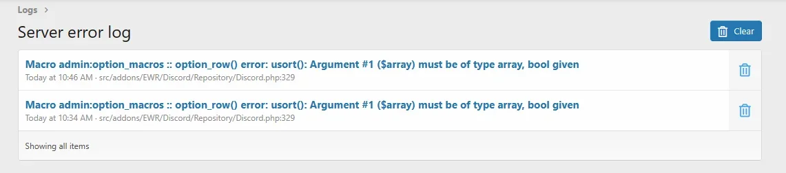

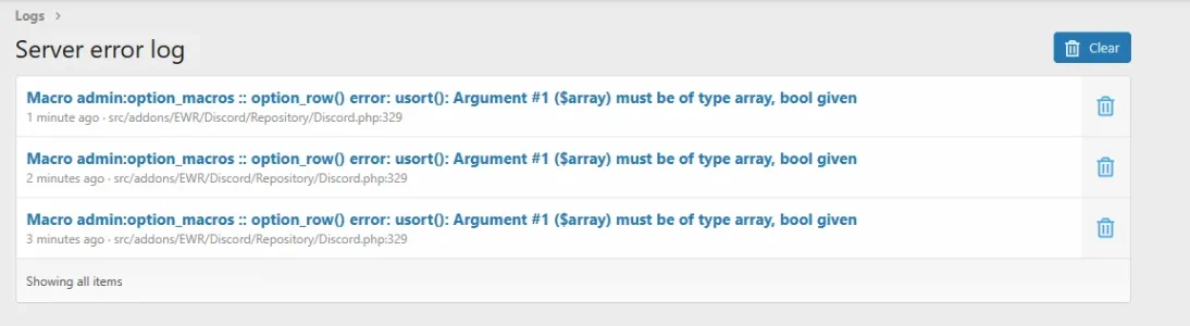

  • I received sever errors. Not quite sure what that is all about (see IMAGE #3 below)
    • Maybe this version is outdated and not working for v2.2.13?
  • It also failed to connect my XF account to my DISCORD account via the ACCOUNT PREFERENCES
    • "There is no valid connected account request available. Please try again."

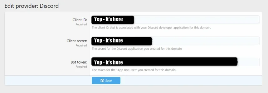

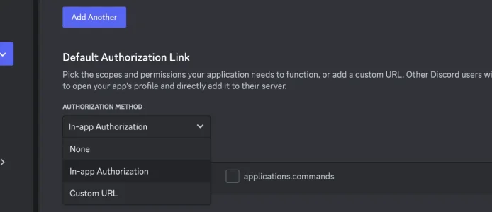

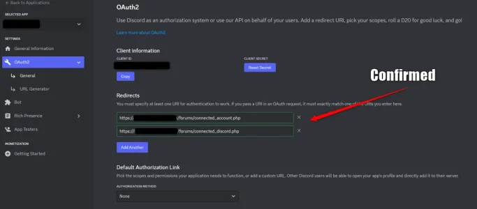

BOT SETTINGS - Redirects are in place.
8WR DISCORD INTEGRATION PLUGIN SETTINGS - Yep, those are there too. Cut and pasted from Discord Development Panel

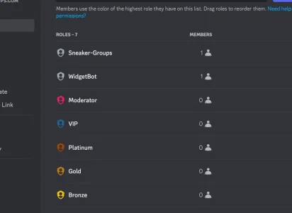

Now, after all this takes place the BOT logs into the Discord Server with no problem and even pulls the correct data from the Discord Server.
  • All the below information is accurate and from the Discord Server.
  • I moved the bot permission group up to the top of all my groups so that it could manage anything below it (if required)
  • I even gave it full permissions including admin privilages in case that was a thing

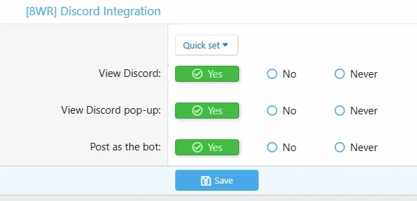

I made sure my Xenforo Administrator Group can see Discord options so they have permissions.

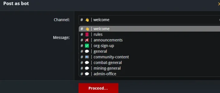

I can post from my forums and it gets posted in DISCORD (so the bot does connect - it isn't a permissions thing there). Here is something I posted in my Announcements Node and the bot placed it in Discord immediately.
So that works.
Post as bot also works (really cool feature btw!!!)
However when I actually try and go to the Discord Server from the site that is where things start to go wrong.
When I click on DISCORD link from my top menu it takes me to the following page where the link that is generated doesn't take me to the discord server that was programmed in the OPTIONS settings for 8WR DISCORD INTEGRATION.

Also, the Xenforo Server error log still exists. Same as yesterday (Although with a few less errors as I'm not even trying to mess with WidgetBot anymore; I'd rather they just go to the server)
Perhaps a new update to your plugin to work with any and all latest iterative changes of XF as well as Discord? I would also recommend that the instructional video be updated as you are using a very early version of your plugin and there have been a ton of changes since.
Can you post the stacktrace to your errors?
Yes sir, I can.
Below are 3 of the errors that were experienced when setting things up with a fresh plugin install for the 3rd time.

#0 src/addons/EWR/Discord/Repository/Discord.php(329): usort(false, Object(Closure))

Looks like this line is returning "false":
$channels = $discordRepo->getGuild('/channels');
This could happen for one of three reasons.
  1. Server ID is wrong, leading to a 404 error.
  2. Discord is rejecting your cURL request, leading to a 500 error.
  3. You have no controllable channels on your server.
Either way, you would have to DM me admin access to your forum, ftp, and discord account to look into it further.

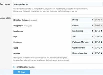

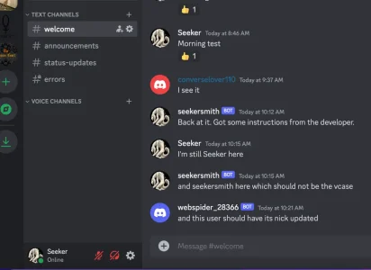

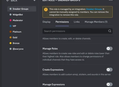

The Bot I created does all the posting things fine but role syncing, nick syncing don't seem to working. Is there setting that need to be turned on? I have them checked in my Discod setting in Xenforo.
Read the FAQ.
Hi,

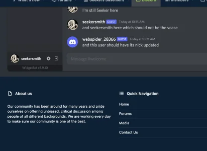

Read it again and yes they were out or order. I'm still having issues understanding the e.widgetbot.io and the web app. Usernames don't seem to update to the xenforo usernames. Roles don't seem to be working on the e.widgetbot.io web app either.

Okay. So if anyone is interested.
So if you edit template: EWRdiscord_index and add username="{$xf.visitor.username}" before the chat size. Your web app will use the site username.You also need to turn on guests on widgetbot
