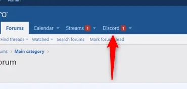

@Jaxel - We've been thinking about this type of integration. I saw in the video that there was a link at the top of the navbar that said Discord and have a red 1 beside it. Does that mean when you log into your forum account it will tell you that you have discord messages waiting?
