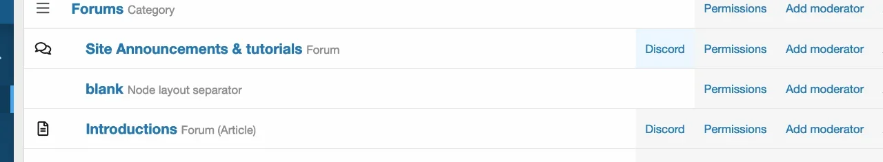

Hello,
I've installed and configured the addon, users are able to sign up, and the bot will post new thread notifcations without issue, however I don't see the "Discord" option under the node settings to allow for pushing through posts on specific nodes, I have the following error which might be related:

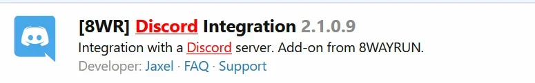

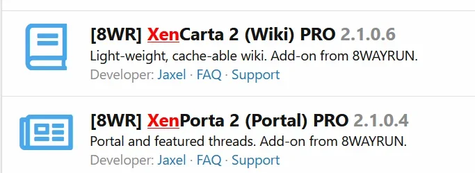

Hello @Jaxel! I've used [8WR] Discord Integration, XenPorta 2, and Xen Carta 2 for quite a few years without issues, on a site I hadn't updated in sometime. Now that I am preparing it for 2.3, I realize I don't even remember what the support licensing was for any of these. The system in place at https://8wayrun.dpdcart.com/portal does not recognize the purchase email. The last update email received was on 2017.
So obviously I don't expect any support/update licenses to still be in place and assume I have to pay full price for an "industry standard" 1yr updates/support license. But would I be able to update from the current version to whatever files I would be served without associating an older account? This addon specifically for example—[8WR] Discord Integration—is currently on version 2.1.0.9 on the target site, prior to some large changes per the changelog.
Is there a process to re-link to older purchase account on your purchase portal system to access older versions to update safely or would an update straight to latest be handled gracefully by the updater? (I haven't been one of those who goes poking at the connected_accounts database entries or any other one for that matter).
@Jaxel
I did not mention XF1; if I misnamed one of your add-on releases, I apologize. Image for literal copy of what's running attached. XF2 only is what I'm referring to.
Rest of my question still stands; please address it:
I would like to continue using your products, but require path to correct way to continue. As the kids would say; takemymoney.jpg.
Do I purchase a new license and make a new relationship through whatever your current portal experience is, or is there something I need to do so that previous history/customer account is linked and no problems with your automation will arise going forward for new updates?
