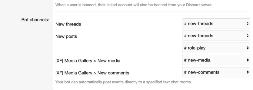

Hello, I have forums that require the bot to post in certain channels. That appears to not be working any longer since the update possibly. I have tested the connection for the bot and it says it is connected but is not posting threads or posts.
Everything is working on my end. Try running through the setup again.
