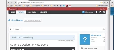

hello, would like to clarify something before I purchase this theme.
I would like to remove the entire logo header from the top of the page:
I would like top navigation then followed straight away by the breadcrumbs
Before: 2014-03-08 11.01.34 am.webp
After: aaa.webp
Is this possible? Sorry if it's been asked before, can't seem to find the solution.
Thanks!!

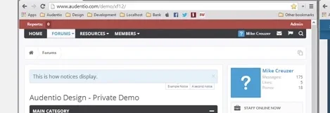

Before: View attachment 68959
After: View attachment 68958
Thanks!!
Yes, you can do that, there is a setting to move the navigation to the top of the page. TO remove the logo, you will need to add a simple line of CSS:
#logo{display: none;}
And thats it! And if you get stuck, we can answer your questions! :)
