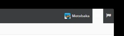

Not sure if this could be considered a bug or not. When in the conversations page the icon disappears. I´ve seen this in AdEx too but it is now fixed. I know Sheldon is working with the theme there so he probably fixed it. Does anyone know how to fix it?
It works fine in the 1.2.3 version.
Not exactly. It only worked in a few situations. But clearly it works worse now so Ill fix it, sorry for the trouble.
What I really really want is for XenForo to add <a class="internalLink">..</a> to all their internal links. Then this is a simple fix.
Yes this is a bug, will be patched shortly. Fixing a few other things as well.

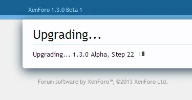

I've just seen that myself when upgrading to 1.3 Beta
It's the ajax loading gif when it's doing the upgrade stages
It's actually the first time I've seen that icon, as it's always shown a box with a missing image before.
Not done any XF upgrades recently, I'm still on 1.2.2. Unless it's a plugin update calling it, but it wouldn't be doing those that early in the morning...

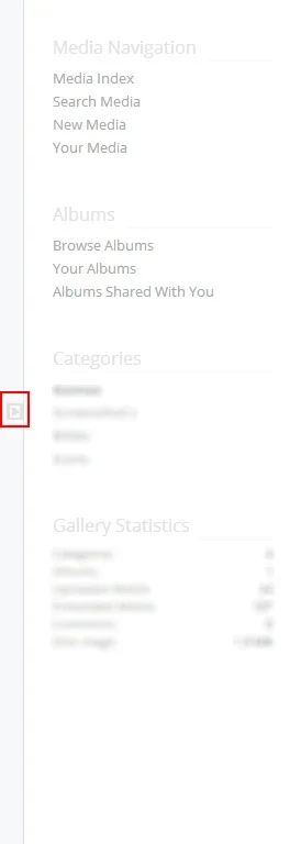

Little problem with Xen Media Gallery.
I talked to @Chris Deeming and I think he said he would fix the issue. Its because the HTML is different than default XenForo's, which is what we base our code off of. Widget framework is similar. If everyone used XenForo's html syntax, we wouldn't have to worry. I completely support Chris' product, it is absolutely awesome, and if he doesn't want to make the update I can make UI.X work with whatever he wants to use. I just need him to tell me what he wants to do ^.^.

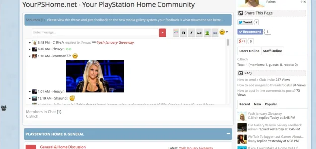

Found a conflict with XenPorta and UI.X. When in thread view the bottom left and bottom right positions are removed.
Could you show me a screenshot? Not sure what positions are. Also, note that XenPorta is not officially supported by this product due to its vast inconsistencies. I try my best though.

I get this also, same type of thing happens with Widget Framework.
As I mentioned, I think this is just due to a missing wrapper on the widget framework. There needs to be a standard everyone follows.
<aside>
   <div class="sidebar">
      <div class="widget">
         <h3 class="widget_title">The title</h3>
         <div class="widget_content">
            The content here...
         </div>
      </div>
            The content here...
         </div>
      </div>
   </div>
</aside>
Hopefully this is something that XenForo helps with.
