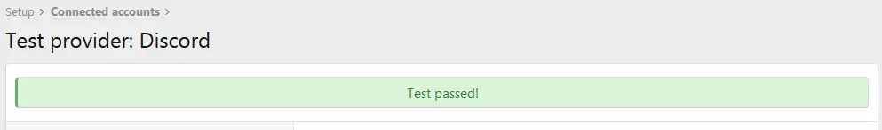

Ah, the connected account status has to be updated each add-on update?And what about your connected accounts settings?
Just in case it could have been a problem with the tokens, I regenerated all tokens and updated them in the add-on settings, too. Unfortunal without a change in behaviour and I cannot narrow down, where this issue is evolving from. Jaxel, any idea? Are there may be known problems when using Cloudflare?And what about your connected accounts settings?

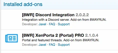

@Jaxel what is the solution?
Install the latest version.
I just upgraded the forum to XF 2.1.4, then upgraded XenPorta to 2.1.0.4, but still getting the error. Is there a later version? I didn't get an email about it. Any help would be appreciated, thanks.Great addon. What's the best way to change the format/layout/design for the email? I'd like to customize the subject of the email, and do some design changes to the email itself. Right now it looks like this:

I reached out to XF support directly and they said:GuzzleHttp\Psr7
is part of XF2.1. If you properly upgraded to XF2.1, then you should no longer get the error.
Yes, every 5 minutes for the last several couple days since upgrading, getting this error.Are you sure you're not looking at old error logs?

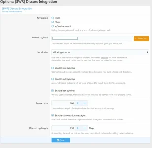

- WidgetBot has been having a lot of issues with their clusters. They shut down their official clusters, and then DisWeb became the official cluster... but then DisWeb had their domain stolen from them by an ex-staff member, so that had problems well. So the cluster/shard option has been changed from a dropdown menu to a simple text field with
disweb.dashflo.net
as the default value. So now you'll be more easily able to change the cluster at will... you could even use...
Just for clearification: I just have to change the Bot Cluster to disweb.dashflo.net and I´m done? Or do I have to make changes to the discord server and the app?So the cluster/shard option has been changed from a dropdown menu to a simple text field with disweb.dashflo.net as the default value.
