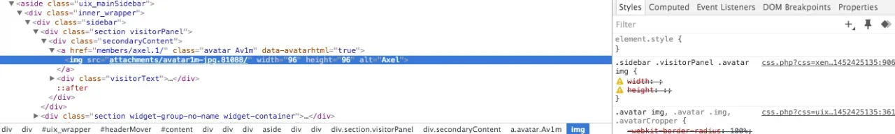

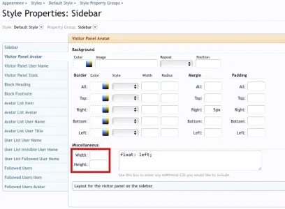

Height and Width are dependencies from a XF core property called "@visitorPanelAvatar"... which seems to be... blank by default. So it can't calculate a Width or Height. I think it can be ignored anyway.

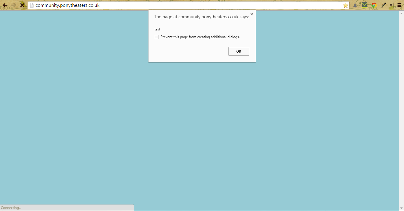

I recently bought this style but I keep getting this popup and I don't know howto disable it
