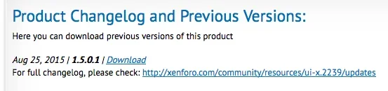

I wanted to install manually but on the Audentio site the changelog for the style was from August.
The instructions don't seem to jive with what has to be done. I wish they were more precise and exact. I'm starting to regret purchasing this

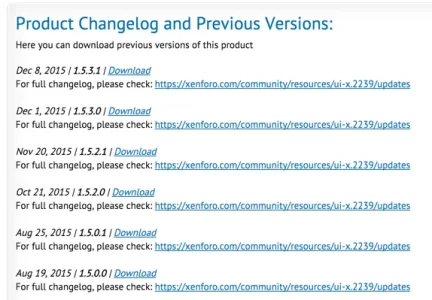

Have you not renewed your license maybe? All updates are showing for me:
Also, are you on XenForo 1.5.3?
Your problem is that you have carried out an install rather than an upgrade.
This is the UI.X thread and add-on here. Rekt is here:
https://xenforo.com/community/resources/rekt-with-custom-homepage.4197/
As you will see, Rekt is still on version 1.5.0.1. Therefore there currently is no update. You need to remove the duplicate parent and child styles that you installed.
What does post #5830 in this thread mean then, if I'm up to date?
Is that why my Audentio page which shows the Product Changelog and Previous Versions is from August 2015 as per the screenshot I posted above?
BTW you can click on the post number (in this case #5830) to get a URL to copy and paste in a post, it saves others having to look through to find the post. Like this:
https://xenforo.com/community/threads/ui-x-paid.57944/page-292#post-1014518
It means the UI.X add-on has been updated, not the style. The add-on provides some of the functionality for the UI.X based styles (which includes Rekt) including the automatic update for a style.
Your style, Rekt, hasn't had an update since August. That's why there is no automatic update option.
If you watch the Rekt thread that I linked you to, that will tell you when there is a style update. You should also receive an email from Audentio when the Rekt style is updated.

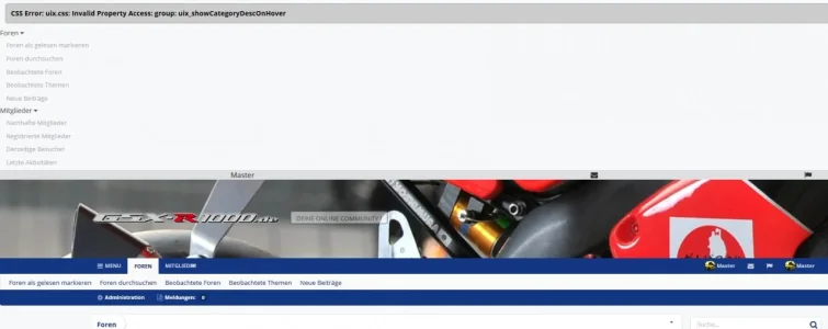

I´ve updated my local testfoum, all templates are merged.
The parent style is ok, my child style looks like this. What´s now?

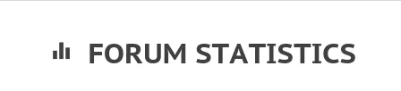

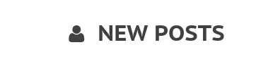

I want to change these font-awesome icons
Where can I change this?
View attachment 123643 View attachment 123644
They are done in CSS. iirc, I added some CSS into Xenith to style the icons to material design.
Try reverting some templates. Remember that the more templates you edit, even in your child, the more you have to merge or revert.
