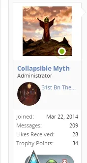

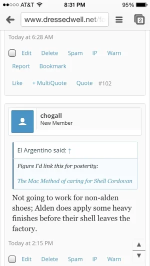

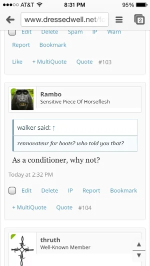

After the upgrade to 1.4, something weird is going on with avatar sizing on mobile iOS:
This is the default
See the white space below the grey block of the name?
See how much more room those two have?

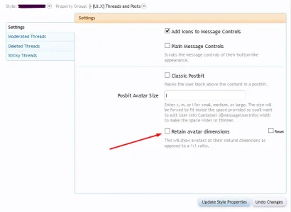

Ok, I retained avatar dimensions, but on the "l" setting, the length of all larger photos now extends WAY down past the grey name area. In the message_user_info.css template, which is the line for the height of the "l" setting avatar? I'd like to keep it the same height as standard, or as it was before. I tried using the medium setting but they just look so tiny.
Same issue here:
Also something weird going on with the Members List node. I have it turned off via the Options -> User Options, but it still shows. Is there some reason UI.X might supersede the default controls in this regard?
Got this working. False alarm.
Had a play with some settings and nothing seems to change how the avatar appears on a mobile, personally I think this option should be taken off and put back to how it was in previous versions.

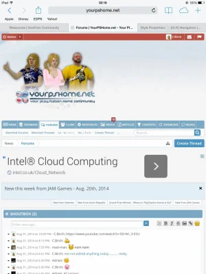

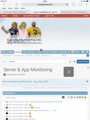

@Mike Creuzer I have just updated to latest version and my nav bar does not seem to wrap anymore on my ipad, it just moves the over flow to below over the sub menu.
You can see, it's covering the latest and new ports sub menu, it used to wrap and add a icon to view the rest of the menu like this.

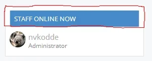

is there an easy way to change the heading block of sidebar items to have no padding? I want to have the heading fill the entire top of the box but still keep the padding on the content below it (avatar, username in the pic).
You could try in your EXTRA.css
.sidebar h3 {
padding-left: 2px !important;
Change the px to whatever you want, if it's not far enough to the left use -2px and go from there.
padding seemed to only move the text in header block rather than the block itself. I tried margin and was able to get it to work. Thanks for pointing me in the right direction!

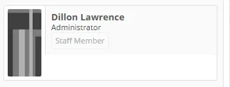

Updated UI.X to the latest and now the avatars are square, have the option checked for rounded avatars. Should note in that everywhere else they rounded but not in the message_user_info_ template
Yes, so we accidentally turned the retain avatar dimensions setting on when we exported. If that setting is on, we remove the rounded aspect on avatars otherwise you get weird oval shapes. Rounded avatars only looks good when they are perfect squares. This issue will be fixed in the next release.
Mike, I purchased this theme yesterday and was not able to download it. I left a ticket, and message on the board, and still no response. Please look into it, thanks.
As far as I can remember I responded to your ticket, but Im not sure if you used the same username there. PM me if it was not taken care of.
So this is what I was referring to
As can see the other items are rounded but not the actual avatar itself. There are no outdated templates and made sure to check that rounded avatars were selected.
Correct, this is by design. What is not by design are some width related issues with the avatars. So apologies for that.

@Mike Creuzer
Is there any solution to the avatar issues?
For now, disable the retain avatar dimensions and put the size back to 'm' as opposed to 'l'. It won't fix the horizontal postbit issue (which is primarily an issue in Chrome 37 as they changed A LOT in this version. So a lot of theme designers and web designers are scrambling on a few things.
That is likely a JS issue. Its hard to say why, but this also might be caused by the userBar. Feel free to create a ticket so I can confirm or tick off the sticky userBar and see if that helps.
