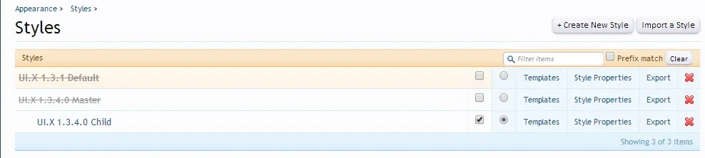

Did you make your changes to a child theme?Ugh im screwed!!! Gonna have to start totally from scratch if i update..thats the only thing about heavily modified custom styles i detest..
lol of course not. thats why im still using ver 0.0.1 beta001Did you make your changes to a child theme?
Yeah. But remember. ANY theme you install, make a child theme. We update our themes, other authors don't. Hence we get complained at when things breaklol of course not. thats why im still using ver 0.0.1 beta001i bet the newer stuff if pretty sweet.
Yeah im not beating you up over my mistake.. This is the first third party style ive ever bought.. Ive always been fond of styling my own sites but i just couldnt pass up the fixed navigation and now im just addicted to the framework/UI and it just so happens to be one of those things i love to hate..Yeah. But remember. ANY theme you install, make a child theme. We update our themes, other authors don't. Hence we get complained at when things break. Do the child theme method and you won't have anything to worry about but standard upgrade processes.
HahaYeah im not beating you up over my mistake.. This is the first third party style ive ever bought.. Ive always been fond of styling my own sites but i just couldnt pass up the fixed navigation and now im just addicted to the framework/UI and it just so happens to be one of those things i love to hate..
This will work perfectly.well i suppose my need to always have the latest greatest has gotten the best of me.... Would this be the proper structure going forward.. (disregard the 1.3.1 build as i will delete that after i re replicate my current style as best as possible..
