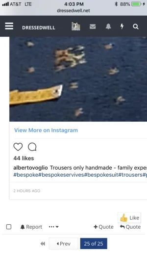

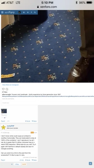

I don't know what could cause an embed to overflow horizontally. They are hardcoded to stop at 100% of the container. I can't reproduce it so all I can do is guess that it's either a browser bug or a weird CSS interaction. What style do you use? Try it again with XenForo's default style(s) and see if it changes anything.
Can you send me a link to the post from the screenshot? I'd like to see it in situ.
@Rambro I remember looking into it a while ago and come to the conclusion it had to be a mobile Safari bug. I have no idea what to do with it and investigating layout issues on mobile Safari is particularly complicated. You can try adding the following CSS to your extra.less template, maybe it'll help:
@media (max-width: 639px)
	[data-s9e-mediaembed="instagram"]
		max-width: 97vw !important;

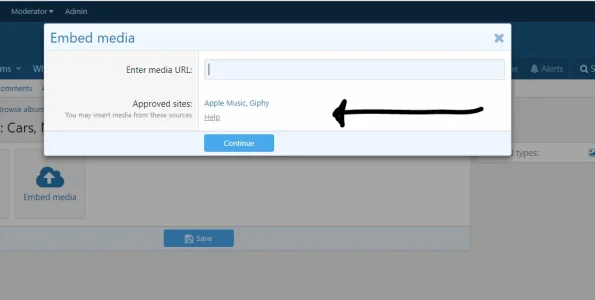

I uninstalled this add-on and it removed the default sites that were there , how can I get the default sites back ?
