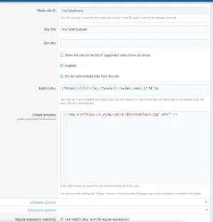

This is probably a noob question, but I'm trying to create a new tag that will just turn youtube links into the thumbnail image when it's wrapped in the youtubethumb tag. I've turned on regex matching and using the same match URL as the normal youtube one but it's coming out blank.
Have I set it up wrong or is it conflicting with the normal youtube tag? I've tried to no avil
Your regexp doesn't actually capture any text for the ID. It won't work if you try copying the settings used in the add-on, you'll be better off copying the default YouTube media site or any media site tutorial. There's another issue in that I don't know how XenForo handles multiple media sites that match the same URL. You'd probably have to disable the regular YouTube embed. You may want to ask in the general support forum about it.
