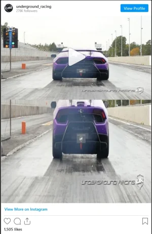

As far as I can tell, it's specific to this video because Instagram's API thinks the post should be 1024px tall for some reason. I tried other URLs and they were dimensioned correctly.
https://instagram.com/p/gbGaIXBQbn/
https://www.instagram.com/tv/BkQjCfsBIzi/
