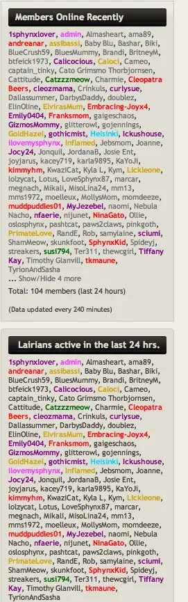

Is it possible that my issue with this add on conflicts with the core Xeenforo sidebar? I have "sort of" duplicate content on certain pages. Any help would be appreciated. One example below.
Make sure you are using the Clear Sidebar widget on every page where you are using Widget Framework. It's probably this that's causing the 'duplicate' - you're seeing the one in the Xenforo side bar as well as the one in Widget Framework as it's not being cleared.
