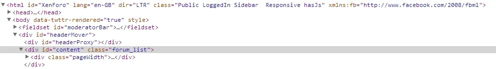

You need to use Inspect Elements in Chrome (or similar in other browsers - possibly not in Safari as that's crap ;) ) It's your friend, you can learn a lot from it and find out many answers to what you need using this.
If you use it on any page, you can find out the template that page uses. If you look at the main forums page and use this, you will see that it tells you that the template is forum_list
Xenforo is nicely built like this, the class it uses for content is the same name as the template. If you go into a forum and try the same there, you'll see that it tells you that it is forum_view.
So, give it a go, try it out on the page you linked to above and you'll then see what template that uses. :D
Once you've seen how this works, Widget Framework is a doddle to use. You simply decide on which pages you want your widgets to show on and in the Position box for each one you add all of the templates for all of these pages. Once you do that, it's done. :)

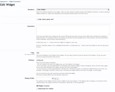

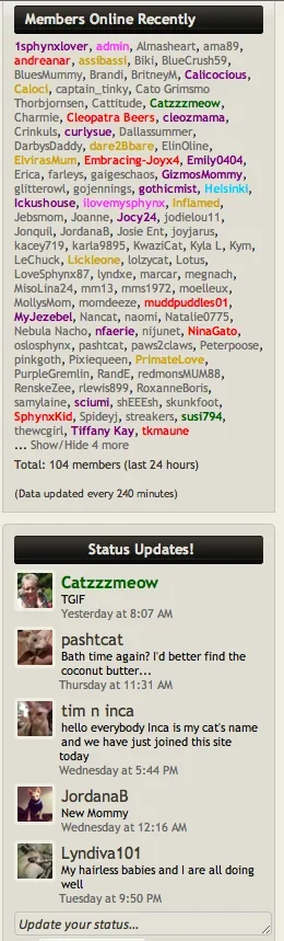

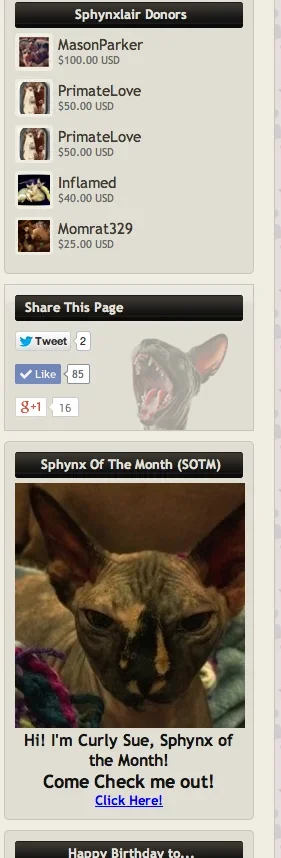

Thanks @Martok - very useful information. However, I still don't understand why i have elements from the core Xenforo side bar. see here, tried adding your clear sidebar recommendation to no avail.
It definitely works, I just tested it on my site.

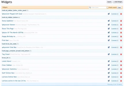

You need to post a screenshot of your entire widget list from ACP > Appearance > List Widgets so we can see which templates your widgets are applied to and the order of these widgets in each template.
Ok - widgets here:

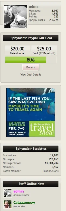

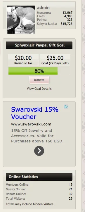

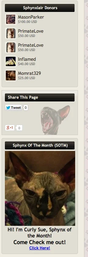

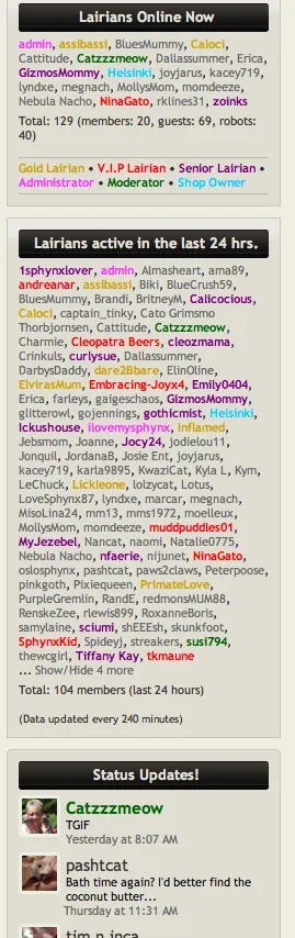

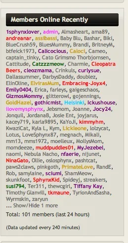

Here is whats on my forum home sidebar:
online_list
The reason it's a mess and not the same throughout all of your pages is because you've got a mix of widgets added to hooks and widgets added to templates. I haven't added to any hooks, mine are just added to templates.
I had to do it this way with hooks to have them align from top to bottom as I wanted them. The normal display system did not work properly for me.
Really? I've got them in the exact order I want them on every page that I want them on and only using templates. I think you may want to look at your setup again...
Clear Sidebar widget must be the first priority in every template.
This is correct too. I think your lack of use of this and not using templates is your problem.
and also, Clear Sidebar will not work on widgets using hooks.
It will just work on regular template, as far as I know.
Correct me if I'm wrong @xfrocks :)
It works with hook positions too but it will also clear existing content of the hook so maybe you don't want to use it for certain hooks.
