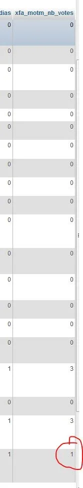

This is most definitely a bug!! Requested bug report to be re-opened on your site
ACP settings
Database (entries where it says "3" were manually changed after contest start, last one that is "1" is the current contest, which I haven't changed yet)
Also is this addon compatible with the lasted XFMG update? Please verify, I don't want it to go haywire if I update XFMG, thinking I will do that after the contest is over anyways
Thanks for reporting, it should work yes are changes are limited in this version but haven't tried yet.
