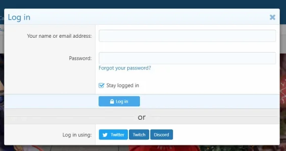

You need to chill out. This happens in the default theme as well.
No, that is strictly an issue with your skin. This is how it looks on the default skin:
It shows up perfectly fine as a button.

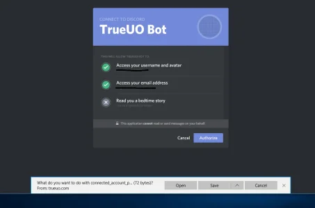

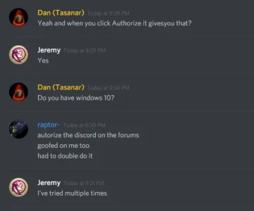

Why does it constantly want to download some file? To check I unlinked my account and it wanted me to download this file. If I click Authorize it gives me the download option to open or save. Only after I save it, exit Microsoft Edge, and retry will it work. My users keep reporting this. Windows 10 edge browser. This is not good and most people will not want to download a strange file to their computer.

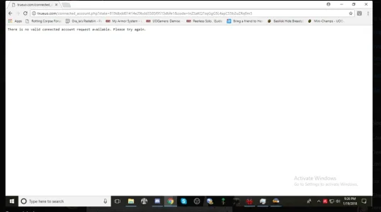

People using Google Chrome get this when they click Authorize
I am using no other edits or addons.
Takes users multiple times and sometimes not at all. I did notice this yesterday too. Took me a few times, had to exit out of Discord and Windows Edge browser. Seems Chrome does not respond well at all. It does work for me but I have to download that file. Most people will see this as unsafe.
