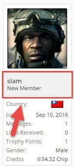

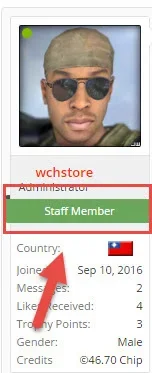

Hi @Mike Creuzer
1. I want to change the color Postbit
2. Registered Groups none
thank you

Hi @Mike Creuzer
thank you
Both just require some CSS. :)

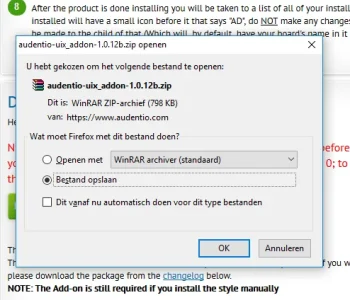

Getting this error with the most recent version
audentio-uix_addon-1.0.12b

How should I proceed?
