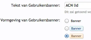

Only have one issue, my user banners are all white. How can I color them? My apologies if I overlooked something! Still a bit of a Xenforo newbie. I did select the colored banners in the user group settings. I know UIX uses a flat design so the gradient isnt supposed to be there. But I've seen some colored ones in this thread.

Sadly, it is not. Example uploaded as attachment. "ACN Lid" should be orange, but is displayed pure white :(
Could it be something that installation (automatic) messed something up? Should I replace the files manually?

The colors on the banners are not going to be the same colors as displayed in the admin panel because the admin panel is using the color pallette from the master/default style, not from UI.X (or your customizations of UI.X). The same will happen if you change your colors on the default style. Unfortunately this isn't something we can really do anything about
Ok! That makes sense. However I selected two different colors and it stayed white. Im also curious where I can change the colors then? I dont mind if Im missing the select banner functionality from the acp, but I'd like to be able to change the colors somewhere :)
Your best bet is to define your own custom banner styling, using the "Other, using custom CSS class name" option. This is what I've done on my site. There's a resource here that explains how to do this:
https://xenforo.com/community/resources/creating-custom-user-group-banner-css.2000/
