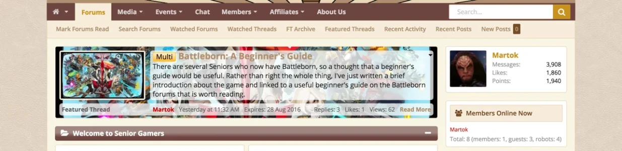

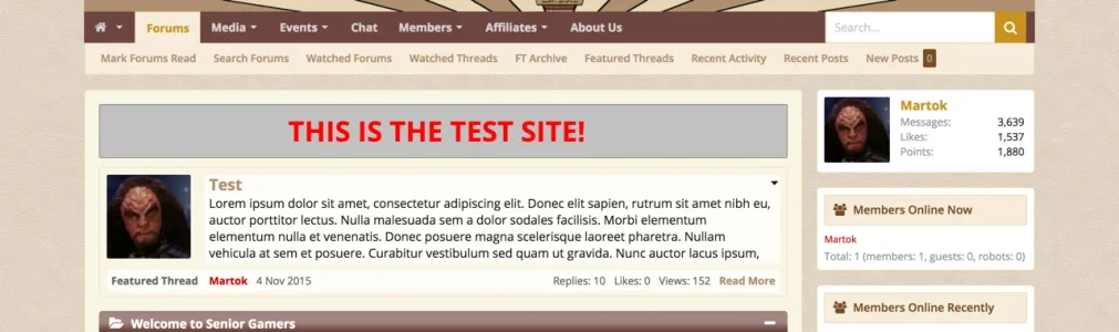

The second issue is that there is that the cream background that goes behind both the forums and the sidebar in 1.5.8:
now only goes behind the forums (not behind the sidebar):
Whilst this may be a new 'feature', personally I don't like it. I want the header and navigation, the forums and the sidebar blocks to be back the way they were, not looking like they are all separate blocks sitting on the tan background. How to I change this?

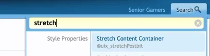

EDIT: Also the "Stretch Content Container" setting reverted itself.
Apologies on this, I've fixed it on our release version, but yes just tick off the setting.

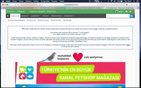

i can upgrade ui.x 1.0.12 but problem.
" Uh Oh! It looks like the version of your javascript functions file does not match the version of your page_container_js_head template. "
I assume you also need to upgrade the theme itself.

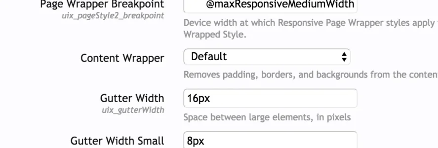

This setting, like stretch of postbit, was accidentally left on. Fixed on our end. But to fix on your end, edit UI.X theme style properties (not your child, well I guess it wont matter), and then change Content Wrapper (a new setting, sorry) to default. It's in UI.X Global Settings

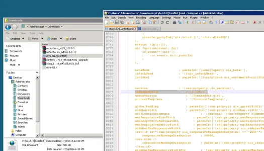

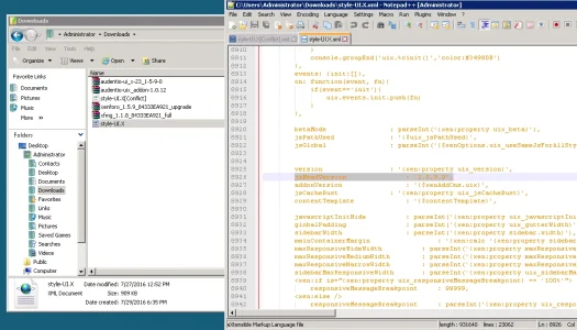

Continuing problems and could not find a solution.
i removed ui.x and I installed a theme but merge template does not work.
style-Uix / page_container_js / head / jsHeadVersion is 1.5.9.0
style-Uix Conflict / jsHeadversion is 1.5.8.1
problems in the my PHP version, i had to style-Uix Conflict
style-Uix Conflict file is not up to date.
