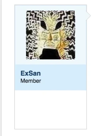

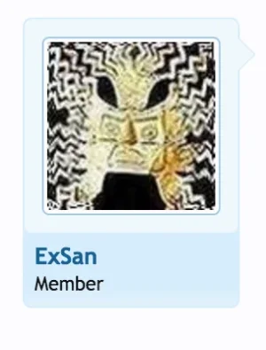

"Stretch Content Container" setting got reverted this update. Just untick it.The avatar block seems to stretch to the height of the post after the latest update.
Here is how it looks (in default style. Notice the bottom of the left avatar block)
And this is after the update, there are white box under the blue block which was not there in previous Flexile light theme.
