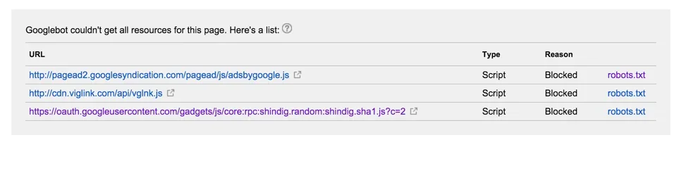

Can you also try resubmitting some of the broken pages to Google Web Cache as per the instructions here https://support.google.com/webmasters/answer/6065812?hl=en to see if it fixes things? Also if you could try the fetch and render in Google Webmaster Tools (under the Crawl section) to see if you are getting anything blocked/temporarily unavailable.

I also did the "Fetch and Render" in Webmaster Tools under Crawl > Fetch as Google. In each case, no scripts were temporarily unavailable. The only things that were blocked in each case (just as previously) are all things I have specifically added to robots.txt (advertising).
