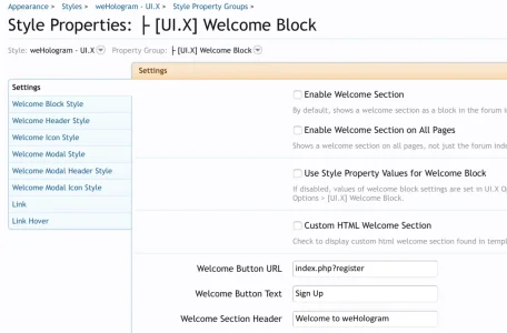

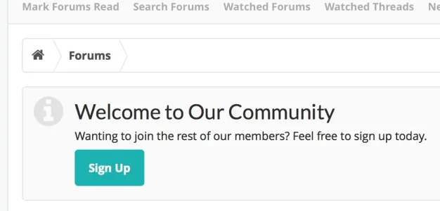

Tick the setting called 'Use style properties for welcome block'.I noticed a strange bug (?) since the last update. While using my Admin-Account, the Welcome-message is displayed on the forum list.
The weird thing is: I disabled it in the settings:
(Also, i see effects when i change the css-style of the message, but there's no effect when changing the title-text for example).
