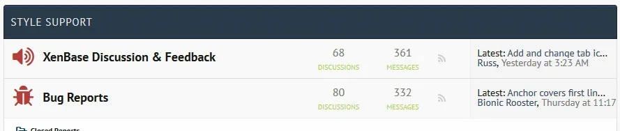

Hey,
I visited PixelExit page and I liked what they have done with their node layout. I would like to accomplish the same thing with UI.X if its possible. I would like to the have "Message" and "Discussion" stats on each node. You can find a screen shot of what I would like to accomplish attached to this post. What steps I need to do to accomplish that?
Thank you
We have themes that accomplish this, but we do not add things to the framework that are strictly style related. That is to say, this framework is a logical system for layout structure and common features. We have themes that do this style, its quite simple but requires multiple edits in multiple templates.
Its something we can consider adding to the framework as this is the third or fourth time I've heard the request.

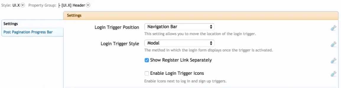

@Mike Creuzer since @Chojo came in looking for the same thing as I am, is it possible that you can show us how to achieve this? Also I noticed in @Mackeral_Fillet forum that he has icons next to Login and Signup, how can achieve that as well. Thank you for your time.
For icons next to login and sign up there is a style property for that called Enable Login Trigger Icons under UI.X Header style property group.

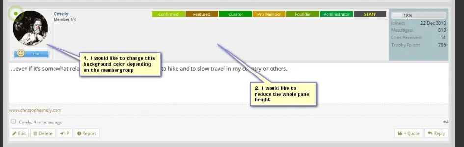

Hello,
I'm requesting some help in making some tuning in this (amazing) UI.X Theme. There's two things I would like to do and I've not yet found how...
1. I would like to be able to define a background color based on member's membergroup in the postbit (see picture attached). Like 'red' for 'admin', 'blue' for 'premium', ... you get the idea
This will require CSS and a template edit. You essentially need to add the user's usergroup to the li class message in the message template. So open the message template, and near the top find:
{xen:if $message.isNew, 'new'}
Replace with:
{xen:if $message.isNew, 'new'} group_{$message.display_style_group_id}
Then in your css, you can do things like:
.message.group_6 {background-color: lightblue;}
Which for the usergroup 6 people make their post backgrounds blue. Naturally you'll need to find what the ID is for each group but the process for the CSS is the same.
2. My Userblock is located above the message (see picture attached) and I would like to reduce the height of it, but don't know how I could do that ?
Thank you in advance for your savvy help :):):)
Well you can do the background thing the same way as above.
As for the height, I mean thats reflecting the height of the avatar plus the user banner. :P You can make the avatar smaller in UI.X Threads and Posts > Avatar size (set to small).
