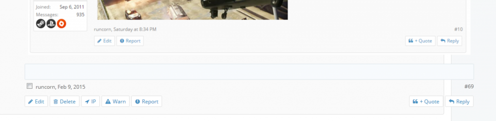

Also the long blue box above the message tools is always on and should only appear once a post rating left, any fix for these issues i can try?
Adding this to the bug list, it might be something we overlooked.

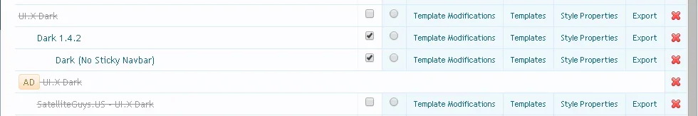

I really don't know how to update my current UI.X (1.4.2). I've installed the AddOn and then UI.X but it created i complete new UI.X Style. My custom style is still a substyle from the 1.4.2.
Did you sync/upgrade or did you create a new style? If you renamed UI.X (ie to include the version) you won't get the sync button (I know its kinda irritating). But yeah upgrading shouldn't install a theme. Its OK though that you did it this way. I would just export your child theme then reimport it into the new UI.X that you installed. Ignore the child theme it created or delete it. Then when you are happy and after you've made backups, delete the old 1.4.2 UI.X and child theme of that. Make backups of course.
Not sure what happened here. But for some reason instead of upgrading the existing UI.X template it created a new one.
Not sure what to do now. I did NOT have the sync button checked as I didn't know what it did and didn't want it harming my other styles.
I don't want to delete the one its created as I can not see no way to reinstall the styles again.
Here is what I see. Help Please!
This is perfectly fine, same issue as above. I would export your child theme then re-import it as a child of the UI.X that you installed. Upgrading does the same thing pretty much. Then, after making backups, delete your old copies of UI.X and the child themes.
