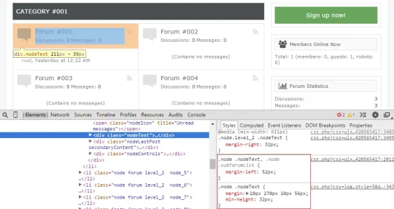

Hello!
I've been trying for some time to change how my forum looks from this:
To this:
All to make things look a bit slicker.

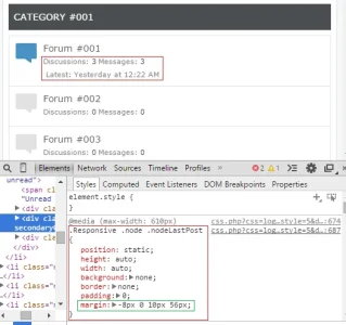

I realized if you "inspected element" and removed from .node.level_1 .nodeLastPost the position: static thingy, this would be the case. However, I have no clue how to apply it in reality.
My website is: www.muffinvibe.com

Right so I see what you want to do. The problem is that there isn't enough room. Look at your forum 'Artistry and Development'. It needs the full space. The node last post area just wouldn't fit :(. I checked all responsive views as well, I think you are best leaving it where it is as well technically it'd be impossible to do.
Isn't it possible to reduce the size of the name of the forums, and thus making it work?

No because its not just the name of the forum thats the problem. Its also the length of the latest post itself. It is inherently not possible. Not because I dont know the code but because I promise you it would not fit :(. Now if you increased the width of the entire forum to be fluid? I can get it there for desktop only which wouldnt look bad.

Thank you and sorry if Im explaining poorly. I can get you the code, but it'll overlap your text :(
Yes I'd love that and try and experiment a little bit with it! :)
EDIT: Right my friend with a lower resolution showed me how it looks if you do what I suggested.
However isn't there a way to make sure there's a certain margin thingy in between Latest Post and the Forum Name and thus making it so they must stay apart?

Update: Okay so we fixed it by making it so if you're under a certain resolution you switch back to the static thingy. Thanks anyways for your kind help and your awesome theme! :)
