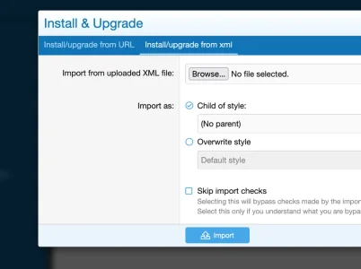

I downloaded the latest version from your site and wanted to Update everything, uploaded the files, but there is no Update button or anything.
Am I missing something?
Thanks
Which one is that?
I have the folder uploads which I uploaded. Then the folder child_xmls and in the main folder the xml called "style-uix"
Hi Will,
I'm using the Variations version 2.3.7.0.0 and there are a ton of outdated templates. Auto merge does not clear them. What is the best way to deal with them all?
Thanks,
Peter
Which one is that?
When you are updating your UIX style itself, you'll want to overwrite your core UIX style with the style-uix.xml file. If you're using the variations version of the style, you'll use the style-uix_variations.xml version instead (in the child_xmls folder)
