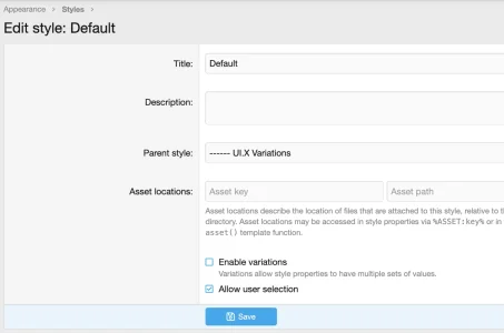

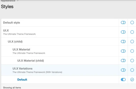

Variations doesn't seem to be working. Every time I select "Light" and refresh the page, it goes back to Dark. What am I doing wrong?
Hi
It's easier to show with images.
First off - With the beta Variations style you don't need to make it a child style; it can actually be set as it's own independent style.
Second, if you disable variations on your child of the variations style, you're basically negating the whole variations system and creating extra potential for problems (given that the variations version of UI.X is in beta). If you don't want to actually use variations, then don't use the Variations version of the style, and just create a child style of your regular UI.X style.
If you want the light style to be the default but still allow for the light/dark variations system, then you shouldn't need to change anything in your child style; the default for Variations has light set as the "default" style.
Now, if you mean you want it to automatically force everybody to use the light style regardless of their system/browser configuration settings, that's something you'd need to take up with XF's variations system itself; as it stands XF's variations system doesn't allow for disabling the auto-detect-by-default. In this situation you'll want to again skip the variations style and just use a regular non-variations style for light, and then create a child style of that to work as a dark version of the style, allowing users to select it using the style selector rather than the variations selector.

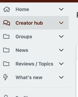

Hi Will,
I didn't realize Variations was in beta. Good to know!
I turned off Dark because when I set my colors for light some of the links in Dark looked awful. I haven't tracked down the setting for it yet.
The big problem is though that the dark / or light doesn't hold between screen refreshes.
When I get a chance I'm going to try Materials again. I just couldn't get my logos to work for desktop or mobile.
Thanks,
Peter

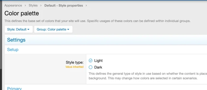

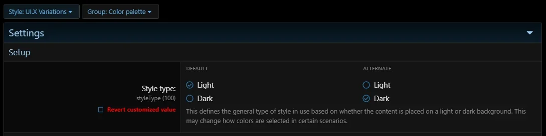

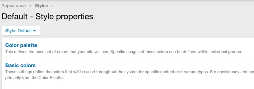

When you're editing a style with variations, are you able to set the alternate variants for the accent colors like the ones noted in this screenshot?
By default those link colors should pull from these in most of our styles; If you use a dark red, for example, in the Accent 3 color, then the active nav item will have that color (since it's pulled from @xf-uix_secondaryColor, which is pulled from Accent 3).

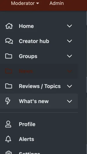

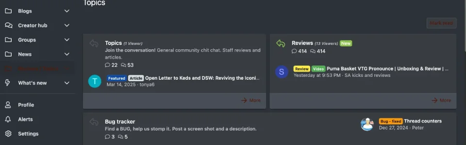

Hi Will,
Xenforo default holds the style variation.
I have been able to correct all the link colors except for the menu. The dark retains the dark red and I haven't found the setting for it. It does not to be set from within Basic colors.
Hi Will,
Sounds like there may be some larger issue at play then; Would you mind creating a ticket so we can investigate further? Just click "Create a Ticket" here: https://www.themehouse.com/contact/support

Without logging in myself troubleshooting is gonna be a bit of a challenge; Off the top of my head, just make sure your style setup has the Varations UIX style as the "parent" style (as in it's not a child of any other style), and that you're placing your customizations in a child of that style - additionally, make sure variations mode is enabled on both the parent and child styles.
