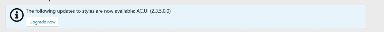

If you're running the latest XenForo (2.3.5), you'll need to upgrade to the latest style; You can hit "Upgrade Now" to update to the latest compatible version.
If you're not on XF 2.3.5, however, you won't be able to upgrade the style yet.
