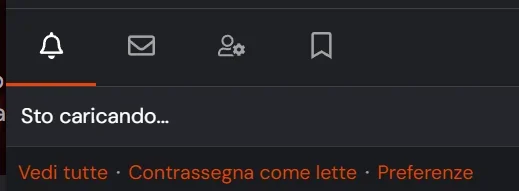

I'm facing this problem with the visitor panel. It stuck with the "Loading" phrase.

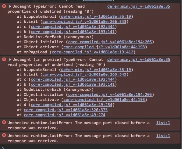

I get this error in my browser console
I tried disabling all my add-ons (Excerpt UI.X 2 add-on) to see if the problem disappeared, but nothing happened. It looks like the style can't load the ajax elements (Such as quick threads, Gravatar profile picture testing, and more).

That's an interesting one; I can't reproduce it myself.
Could you go here: https://www.themehouse.com/contact/support and click "Create a Ticket"?

Resolved a Javascript error that could prevent AJAX content (such as notifications) loading in limited cases
