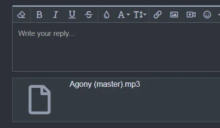

Hi, I'm using your addon with great success. Thanks! However I need to allow members to upload mp3s to threads (under 20MB), and present the file in a player format. It would be great if they could just "Attach file," or something as simple as that... Suggestions? I have Audio 1.2 addon, but so far I haven't been able to get results. Name of file, link to file, but no mp3 "player." Is this fixable?
