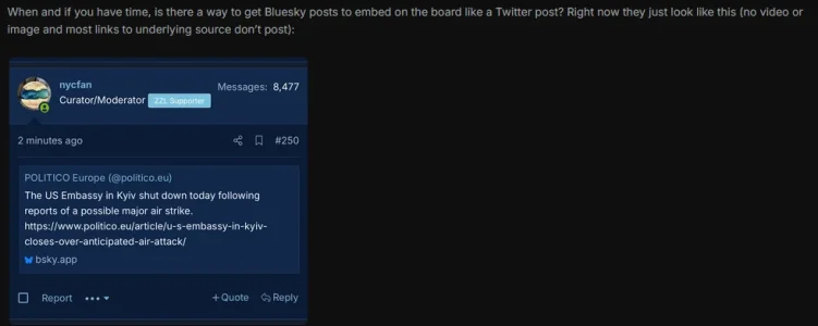

iirc this has been asked before and dev showed interested but wanted to know if someone knew of third party server connecting with the primary portal to see how to go about it. mastodon requires special treatment as it is hosted on multiple domains. bsky is probably same.
I keep wondering if Twitter changed something again? But why do they work just fine in the test post forum? I can render YouTube, and some Twitter posts just fine on my board, but others will not. With @JoshyPHP addon everything works flawlessly.
I've just checked Twitter's oEmbed endpoint (in isolation, outside of XenForo) and the first couple of attempts failed before working reliably. My guess is there's some reliability issues in Twitter's infrastructure, it might just be random.
@Mirabilis @Swiftman @Poindexter @RenegadeMonster @RoyalRumble With regards to Bluesky, I have done some preliminary work some time ago but I haven't had time to finish it. Federated sites such as Bluesky or Mastodon require some special treatment in order to be used safely and unfortunately each site has a slightly different way of doing things which requires its own custom solution. So in short, Bluesky is on my TODO (or rather, TOFINISH) list and it is my intention to do it this weekend because after that, I'm going to be busy for the next two weeks.
Either way, I will update this thread in a couple of days with a more solid timeline. Be sure to watch this thread so you're notified as soon as I do.
Appreciate the update JoshyPHP. I suspected it might be a PITA given how they do things with BlueSky. I'll let my forumites know that it will be a case of at some point.
Take it easy
Mirabilis
I've just published the update. I have a bunch of tests to ensure that things work as expected but if there's any issues I'll make myself available asap.
The bsky.app is allowed by default. AFAICT Bluesky doesn't have a dark theme for their embedded posts but if someone finds any info about it, send it my way and I'll look into it.
