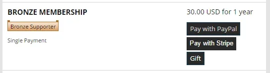

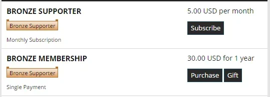

Yeah looks like it's all in the account_upgrades template. When an upgrade doesn't have Can be gifted selected the button is removed. With Paygates turned on it's added back in.
I've been wanting to clean up the appearance of this page anyhow, so I'm gonna try to hack something together.
I should probably let @NixFifty and @xfrocks know we're talking about their addons here too :D
[bd] Paygates off:
[bd] Paygates on:
