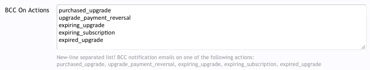

Feature Request: Expiring Upgrade eMail Option that sends a CC: eMail to the Board Admin eMail Address for the expiring upgrade and the actual downgrade... I find it very important that the board admin gets notified if a user does not renew his upgrade. I wonder why this is not core XF.

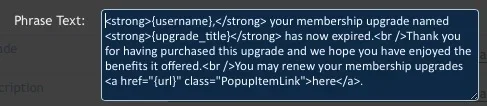

Phrase Bugs: Found some email and alert phrase issues where the "Upgrade URL" is not correctly used... and therefore will lead users to "page not found" errors.
https://www.mywebsite.com/%7Burl%7D
In some phrases you just have the {url} as the placeholder which then results in a path error.

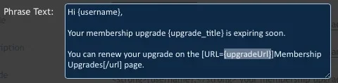

Other phrases have what (I guess) is the correct placeholder:
Please check all phrases and fix this.
