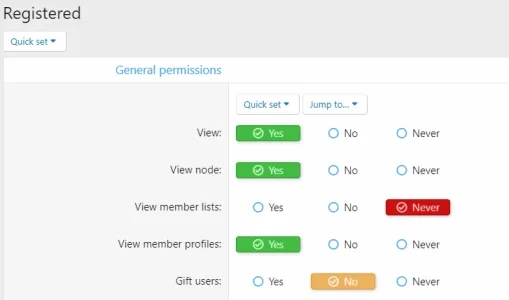

Hi @Xon, thanks for the recommendation! I just tried to use the analyze permissions function. This is what I am seeing.
Tagging @NixFifty for updates too!

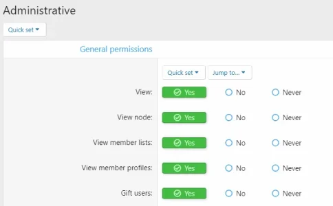

My base registered user group permission is set to "no" for gift users
My admin user group permission is set to "yes" for gift users

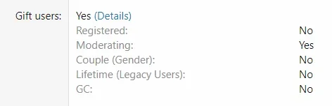

When I analyse my admin user's permission, the gift users permission is indeed set to "yes"
However, I still do not see the gift button on the front end when I am logged into my admin user.
XF permission heirachy is such that "yes" overrides "no", but "never" overrides "yes" am I right?
I believe the permissions here are a little mixed up, and "no" is overriding every other permission option.
