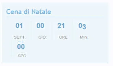

I've installed on 1.2.3 and it works but it appear a little messed up like in the attach and in the last position in the sidebar. Can anyone tell me how to fix the display and put it in one of the first positions in the sidebar?
thanks
