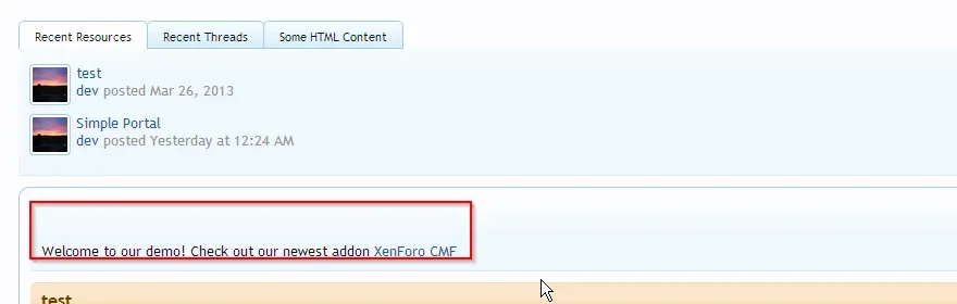

I would suggest to allow empty titles
If i don't use a title => it's the default widget title
If i use &nbsp; as title, the title is hidden, but the output is
 <h3>&nbsp;</h3>
which is also not nice because of the empty line above the content
e.g. this is a html widget with &nbsp; as title
<div class="secondaryContent widget {$tab.class}" id="widget-{$tab.widget_id}">
<xen:if is="{$tab.html}">
<h3>
<xen:if is="{$tab.extraData.link}">
<a href="{$tab.extraData.link}">{xen:raw $tab.title}</a>
<xen:else />
</xen:if>
</h3>
{xen:raw $tab.html}
</xen:if>
</div>

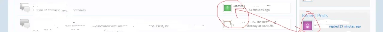

Good Afternoon,
Just a quick problem. Different avatar showing for same person. Member has not uploaded an orginal or new avatar. See attachment. Thank You!
Good Afternoon,
You are using the New Replies type? There is one conflict issue with another add-on that I can't remember now. Can you provide list of installed add-on?
