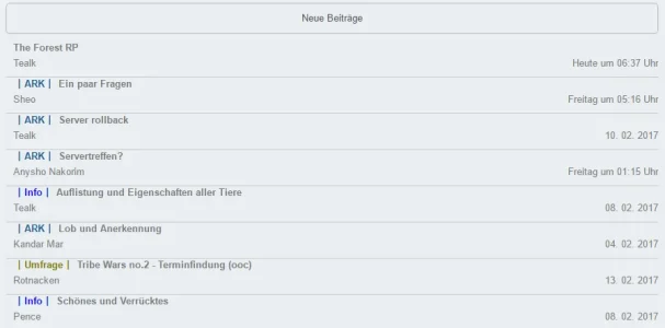

And has someone an idea why the order is wrong?
Widget Type: New Threads

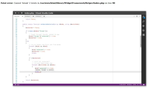

PHP 7.1 is too strict (had to update my Advanced Styling Rules add-on because of a similar fatal error).
@@ -87,7 +87,7 @@
                     $tab['selected'] = true;
                     $selected = true;
-                   break 2;
+                   break;
EDIT:
The latest version has that fixed.
Conveniently, it can be found at the developer's website and on github: github.com/xfrocks/bdWidgetFramework

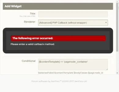

While adding a widget, every time I just select PHP callback renderer, I get an error "Please enter a valid callback method." All I do is select PHP callback and it doesn't give me a chance do to anything else and display this error. Any idea why?

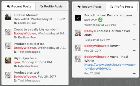

I'm trying to create a feature that allows users to cycle through the normal info shown on sidebars, because my sidebar is fixed but I still want to display everything in it. I'm looking for something similar to this website's sidebar, where the Xs toggle the different tabs. I've tried out a ton of codes already, and in the end result none of them have any real similarity to what I'm looking for, so I'm desperate at this point. How can I code this with the Widget Framework? I really have no idea what I'm doing with this add on, to be honest.
@aeriverse Are you using the BETA version? In the BETA version, you can "group" multiple widgets and then you can choose the group to display as tabbed widgets. It used to have some bugs in the old BETA version, but the bugs may have been fixed by now.
edit: I attached an example from my site.

I'm not sure what you mean by BETA version, but what would be the code for this grouping widget?
