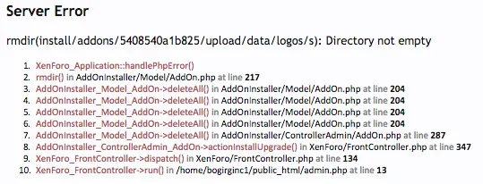

Hi Chris,
While I was trying to update by using Option 1 for XenReviews, I am keep getting this error:
Later I was suggested to "delete everything under install/addons" but it didn't help neither. Even though I have deleted everything under intalls/addons, when I click to update a new folder appears under the same spot. Any idea what might be causing the error?
Thanks!

Hi Chris,
In regards to @puropedia's report, and several other users that have tried to use your installer to install my add-on, I finally dove into your code to find the issue. Wanted to post this here so you can get it included in the next release.
OPEN library/AddOnInstaller/Model/AddOn.php
FIND
PHP:
while ($contents = readdir($directoryHandle))
REPLACE WITH
PHP:
while (($contents = readdir($directoryHandle)) !== false)

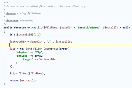

Is it possible that the uploaded files get there own folder so they don't spaam the root folder?
It doesn't do that... it extracts files to the install/addons folder.
This is the part of the code that handles that:
It always uses 'install/addons' as its base directory for extraction.
ok, yes i see but why i have there some .rar and .xml? now i'm confused
in install/addon i have only 3 zip :/
Technically, you shouldn't have anything in install/addon because it is supposed to clean up the files after install (but sometimes that might fail).
Anything in install/addon can be removed.
It's possible that one of your add-ons includes a rar and an XML file in the root of the ZIP package. It's preferable that add-on developers put everything they intend to be uploaded into a folder called "upload". The logic my add-on goes through then finds that the easiest way of identifying what should be "uploaded" and what shouldn't.
In the event my add-on can't find an "upload" folder in the ZIP file, it will go through a process to "guess" the correct files to upload.
Alternatively, the add-on developer has decided to put a rar and an XML file in the upload folder in which case that will just get uploaded into root.
If you can identify which add-on it is I can explain in more detail why it's happening, but there's probably not a lot I can do about it.
