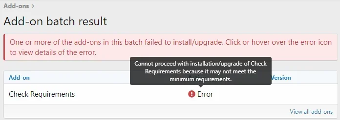

When using the archive installer to install or upgrade an addon, but there are requirement failures - the message returned to the admin does not include full details of the error like you see when installing/upgrading using the main UI after a manual addon deployment.

I was testing
checkRequirements
functionality of addon setup files, so I created a simple addon that contained nothing more than an addon.json and a Setup.php with my checkRequirements
function which sets an error string. The add-on batch result page informs us of an error, but does not provide any details:
If you then click the install or upgrade button in the UI to try again, you get the full error information:
You also get the full error details as expected if you manually deploy the addon and use the "installable"/"upgradable" addons UI to install or upgrade the addon, so this issue specifically relates to the archive installer.
Suggested fix: please make the "Install/upgrade from archive" function report the full error text from the addon during install and upgrade failures.
