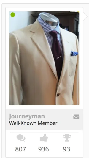

Any template magic to shrink the vertical size of the Large avatars? This height is a little excessive:
If you go to Style Properties > UI.X Threads and posts > Avatar size, change from large to medium. Large avatars do not get cropped.
Please do create a ticket at audentio.com, we will take a look and find out how this could have happened.
I know Mike. I would like to go with the width of the large but the height, relatively speaking, of the medium. The large avatars create a very tall postbit. The members find it distracting. Is there a way to limit the height of the avatar showing while having the large avatars selected?
You can, yes, with some extra code. If I understand you correctly this should work. Add to extra.css:
.messageUserBlock div.avatarHolder .avatar img {max-height: 100px;}
May want to check mobile as well. :)
Have you started hard coding the child node font awesome icons? Could have sworn there was a SP for them previously?
Hi @MattW sorry to bug you but I completely misunderstood this, and I didn't realize it until a bit ago. We are building this into the next release, we have a system where you can edit node icons on a per node basis or edit all of them. Its all built we're just going to wait for some beta testing (from you I hope! <3) and also the next release of XenForo likely.
So it looked a little weird on mobile, with a lot of white space, and on the desktop. 150px seems to fill the gap better and bridge between the huge size of large and the tiny size of medium. Its weird though how it doesn't always expand for width automatically with some images but it does with others. I guess that's a function of the original image size.

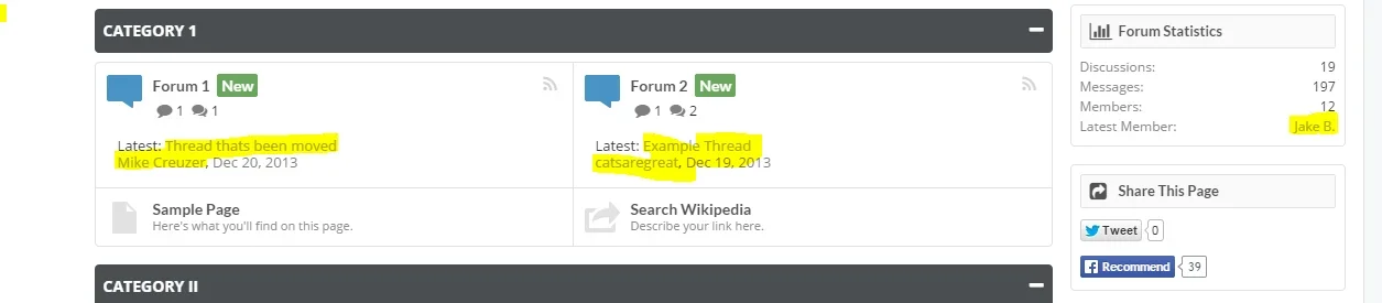

Also just wondering which style property controls these fonts?
