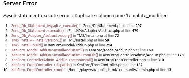

Well, obviously other than this post where you are instructed to drop the tables and start again, nobody knows.
Bumping this thread every day is not going to help. Try contacting the author directly.
it does not matter! I deleted the template from the database, ftp again, reinstalled but it does not matter! Mr. creator you not a solution? 1 Week bug that I almost ...
Try...
ALTER TABLE xf_template DROP template_modified, template_modifications
Edit:
To guiltar - probably best to remove the addition and then removal of those columns from the install file since they are no longer needed.
