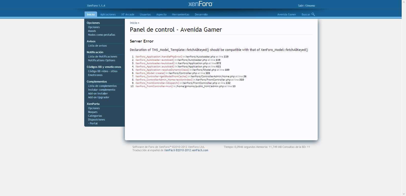

gimomo
control panel ... initial part throws me the following error after updating:
