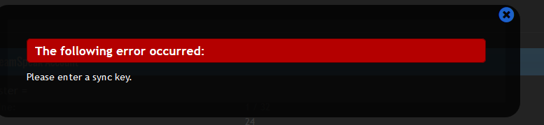

this probably has been asked but how to i enter a sync key ?
I cant find that option anywhere ?
That should be happening automatically behind the scenes. I'll check it out, you shouldn't be seeing that.

I remove addon and reinstall 7a now I get the please enter a sync key
I'm trying again to do a fresh install hope It will connect and sink my client to my Forum
