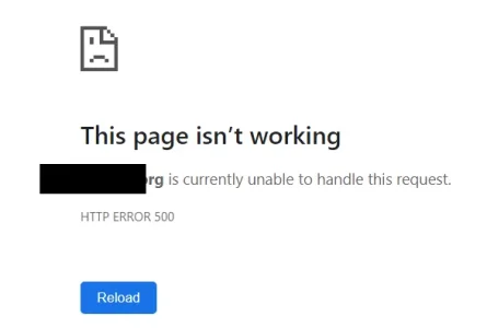

I just applied the latest update and my Xenforo immediately went offline.
Can you think of any reason why the update would do that?
I uploaded the update, then I clicked the browser shortcut to the Xenforo control panel and it gave an Error 404.
Website was suddenly down.
My DB seems fine. Web service is fine. Maintenance message applied and working.
I'm on XF2.0
No add-on should be able to cause a 404 to happen. If you're on PHP 7.0 it could theoretically cause a 500 error, but not a 404.
I'm sorry, I just double-checked and it actually was a 500.
Do you know where I can research what I might have done wrong and how to fix it?
I'm 7.x, I think PHP 7.2.
The current add-on requires PHP 7.1 and older versions of PHP may cause a 500 error. You should try reuploading whichever version of the add-on you upgraded from.
Definitely check which version of PHP you're actually using first.
We have PHP version 7.2.34..
I restored my server to an image backup from earlier this morning.
Will probably wait till after-hours before I attempt another s9e update.
Nobody else is reporting issues so it's probably something weird on my side.

@CZ Eddie For what it's worth I tried the latest version of the add-on on XenForo 2.0.12 running on PHP 7.2.34 without any issues. It's theoretically possible to cause a 500 error if you upload the add-on's PHP files manually and something happens during the transfer. It's less possible if you upgrade by uploading the ZIP file. Let me know if you find out what went wrong the first time.
