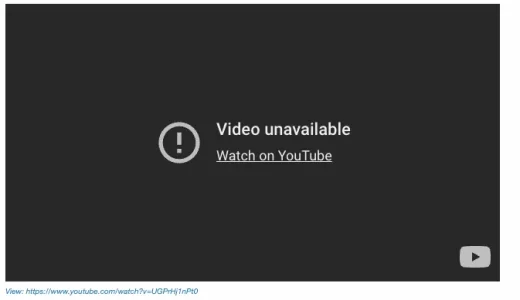

Is there anyway around Youtube blocking embedded play?
I don't think so but if you send me the video's URL (here or in DM) I'll take a look at it. It's theoretically possible that blocking referrers may make it available. Either way it won't work around geoblocking. An alternative frontend such as Invidious may be an option, although I haven't tried it personally.
https://www.youtube.com/watch?v=UGPrHj1nPt0
Unless geoblocking is only on embedded player, it works/plays within YT.
It's not just geoblocking, publishers can disable embedding altogether, or with some granularity (restrict to a list of domains, for example.)
By the looks of it, this specific video doesn't allow embedding at all. It is possible to embed it via an Invidious mirror, but I don't know what form it would take at the add-on's level and I'd have to spend more time thinking about it. If that type of videos is frequent on your board, you may want to create a custom Invidious media site using your preferred instance.

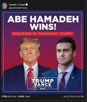

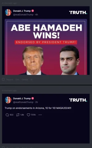

Hey @JoshyPHP We discussed Donald Trump's platform TruthSocial and how to add the capability by adding it to Mastodon hosts. As someone later pointed out, he is the Republican nominee and his platform is probably utilized by millions of people and having a forum full of users that are talking politics for the next 3 months, it would be super sweet if there was any way to figure out why the "Truths" don't embed properly due to height issues. The two pics below just illustrate a tweet of his w/ a pic that doesn't display fully (and then what it's suppoosed to look like) and then a short tweet of his that for whatever reason has an extended lower area.
If it's an issue on their end or too difficult or whatever, understand. Not that big of a deal but boy, it would be pretty cool if it worked. Thanks either way. Great add-on.
If it's an issue on their end [...]
Yes, I'm afraid this is entirely on their end. From what I understand, Truth Social is based on a fork of Mastodon that has not been kept in sync with the original. Comparing their embed.js file, I see that they are missing this fix related to embeds' resizing. Truth Social's embed.js file contains a custom modification that adds a fixed amount of padding set to 165px, which may be an attempt to mitigate issues related to resizing, I don't know.
There is a secondary issue in Truth Social's code in that (as far as I can tell) they have disabled this part of the original code which is responsible for answering queries about the embed's height. Being aware of potential resizing issues in that type of embeds (Mastodon or others, this is a common issue) I have set the add-on to periodically ask/poll the embedded page about its current size, so that even if the provider (here, Truth Social) does not proactively notifies the embedder in real time that the content needs to be resized, it should still end up with the right dimensions eventually.
Your best bet here would be to report this to Truth Social's team. If they re-enable communication (the embedded page needs to reply to setHeight messages) then the embeds should get resized correctly. I should also mention that their official embed code (seen below) suffers from similar issues. The content isn't resized to the correct dimensions, although you still get to see 165 more pixels of it due to the fixed padding.

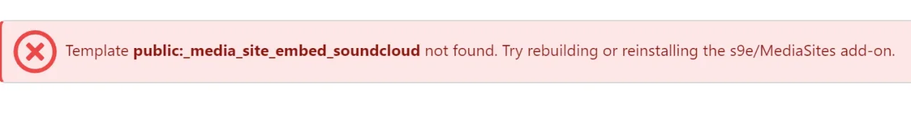

[MEDIA=soundcloud]track_id=8735394[/MEDIA]
That's a different error message, but at least with this one you know what to do: reinstall the add-on and it should be fixed.
I already did but it didn't fix the issue. It is not a diffrent error message. Admin log error is same. This is what you see in the frontend.
